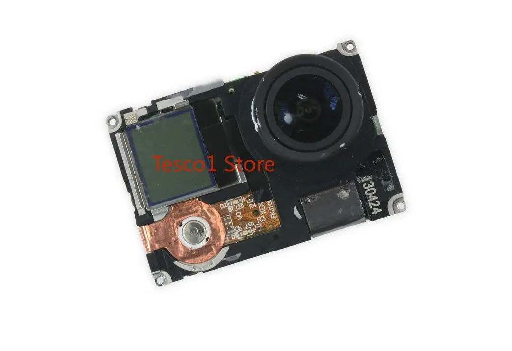

Some time ago i found very cheap GoPro3 on Aliexpress: 47.31€ |Original Für Gopro Hero 3 + silber Vollversammlung Bild Sensor LCD Montage Objektiv Motherboard Reparatur Teile|Karosserieteile| - AliExpress and decided to buy it.
Arrived in paper box, bit better than just soft package. So:

- something is not right with mainboard. Seller photos shows correct GP3B board. I also had few and remember that shutter button was 3-p connector. But board i got looks more like white (or silver?), with 5-p connector. It still records 1080p@60 and reports as GP3 Black on serial console and on version.txt so probably this is just some strange board revision:
“info version”:“1.1”,
“firmware version”:“HD3.11.03.03”,
“wifi version”:“4.0.36.1”,
“wifi bootloader version”:“0.1.0”,
“wifi mac”:“d4d9191d3ceb”,
“camera type”:“HERO3+ Black Edition”,
“camera serial number”:“H3B+EDITED”,

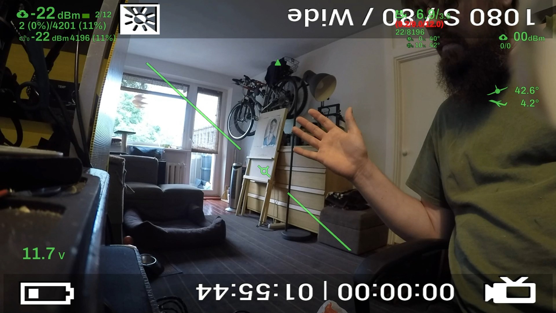

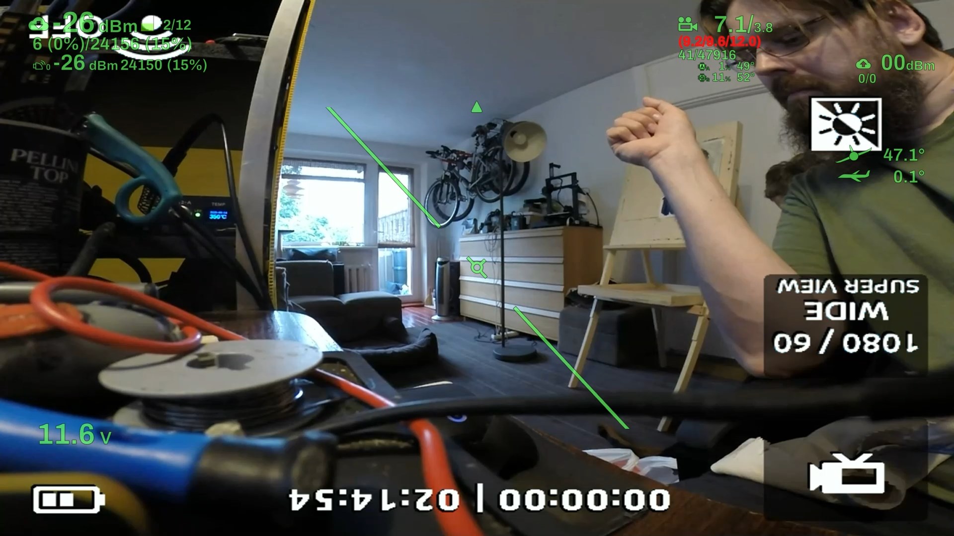

Now about HDMI - without superview everything is fine. I’m using cheap ali HDMI2CSI converters, if superview is turned off - then it works every time, at least for me.
With superview it’s a bit worse. Need to turn on camera, then connect HDMI, only then image will appear, else - just black screen. I did not had this issue with GP4B, but again, i did not tested every possible mode.
I did not tested every possible combination with GP3, but looks like 1080p@30FPS+superview has this issue every time, @60FPS looks a bit better, but when plugging both camera and RPI at once is still not reliable.
So, great deal if you can live without superview (ambarella + protune => amazing videos, also you can get some kind of superview by using AE, avisynth scripts…), not so great but usable when using superview.
