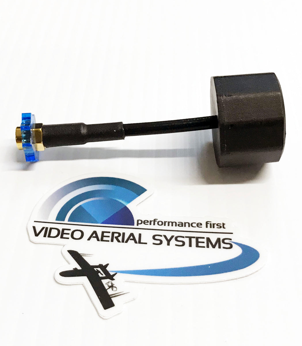

An example of CP antenna that I am considering is the VAS Madmushroom V2 CP antenna which pretty much covers the entire 5Ghz range and is suggested for HD systems.
