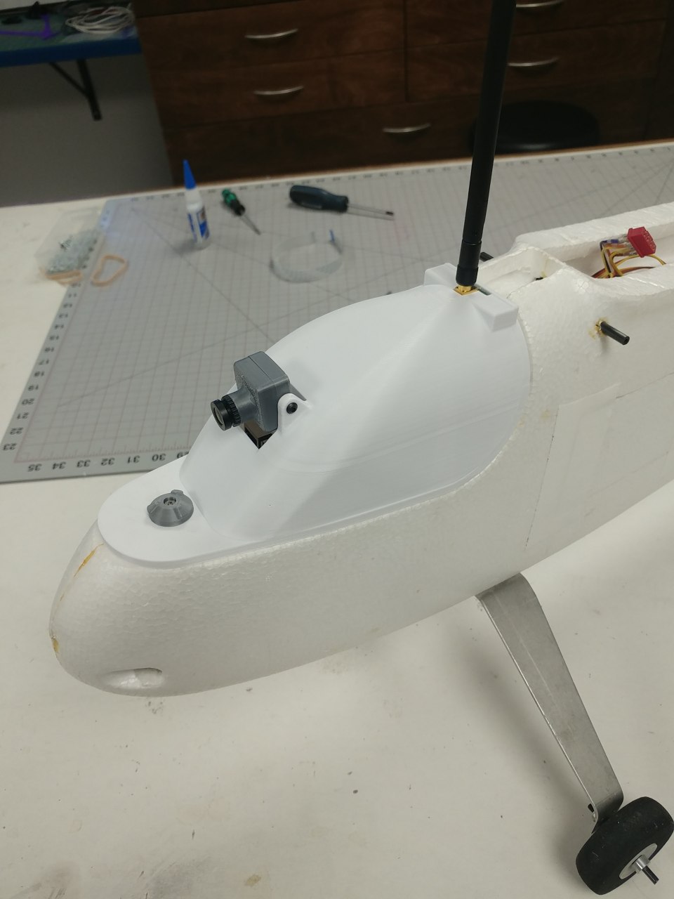

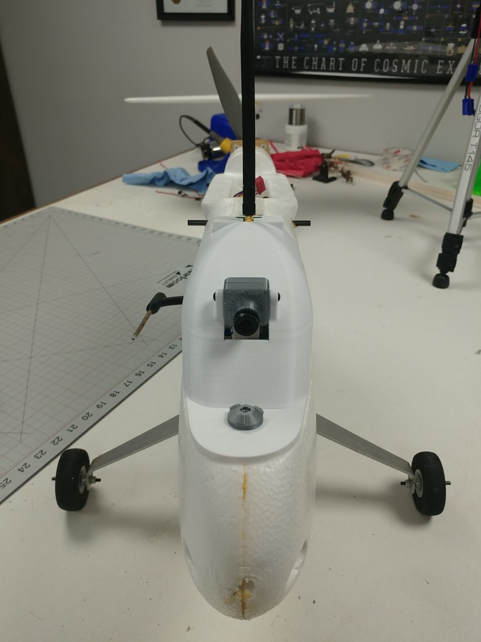

Designed to hold a Raspberry Pi 3b+, a 3A voltage regulator, a Pi Cam v2, and an Alfa AWUS036NHA WiFi card.
- #6 x 3/4" (x6) screws to hold the canopy to the base
- M3 x 8mm (x2) with threaded inserts to mount camera to canopy
- #2 x 1/2" (x2) to hold camera case halves together
- #2 x 1/4" (x8) to hold pi and AWUS036NHA card in place
- Hot glue to mount the regulator
Included is a camera front for the stock lens for the Pi Camera v2, and a threaded mount to allow use of M12 lenses.
Just unscrew the stock lens from the mount, remove the foam pad under the sensor, and glue the sensor to the board.
