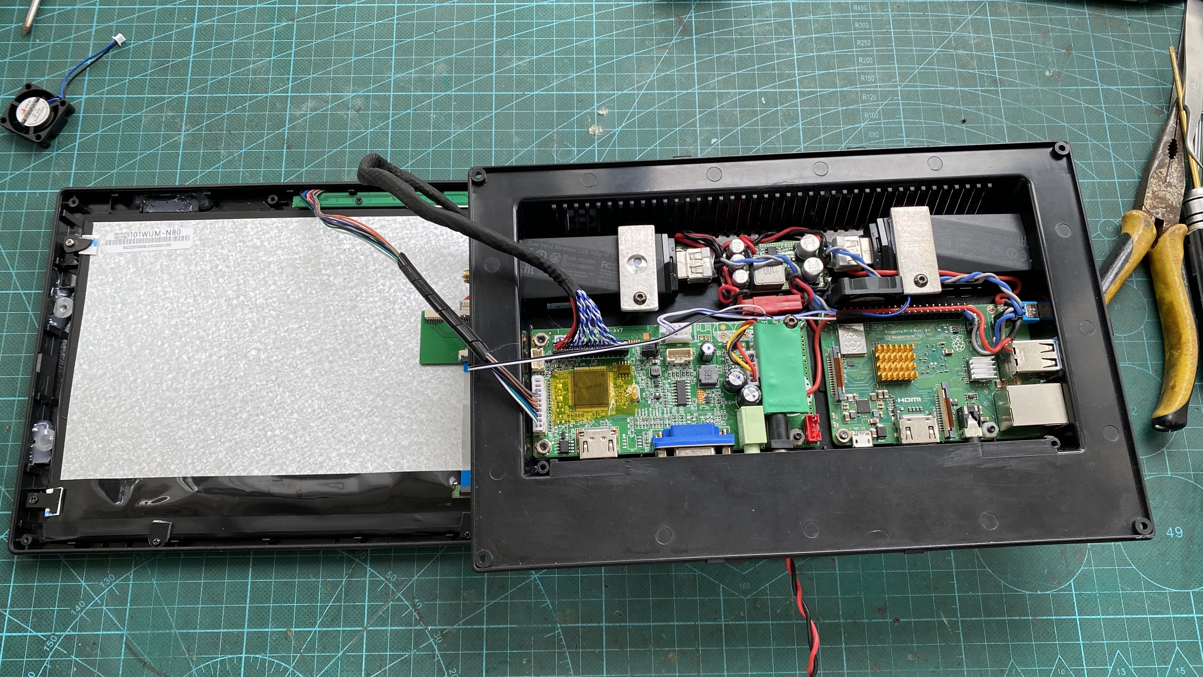

here is my diy HD video reciver , hope you like this video .
very integrated

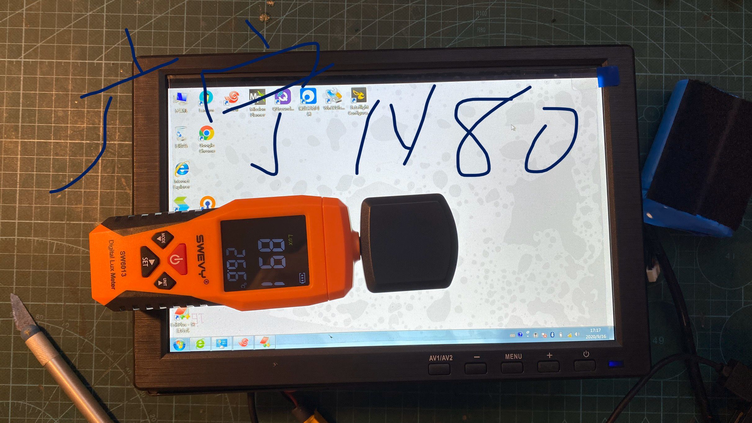

this LCD made in china and it had led backlight , brightness . I tested it , 891 cd/dm2
its 1920*1200
compare to ipad air3

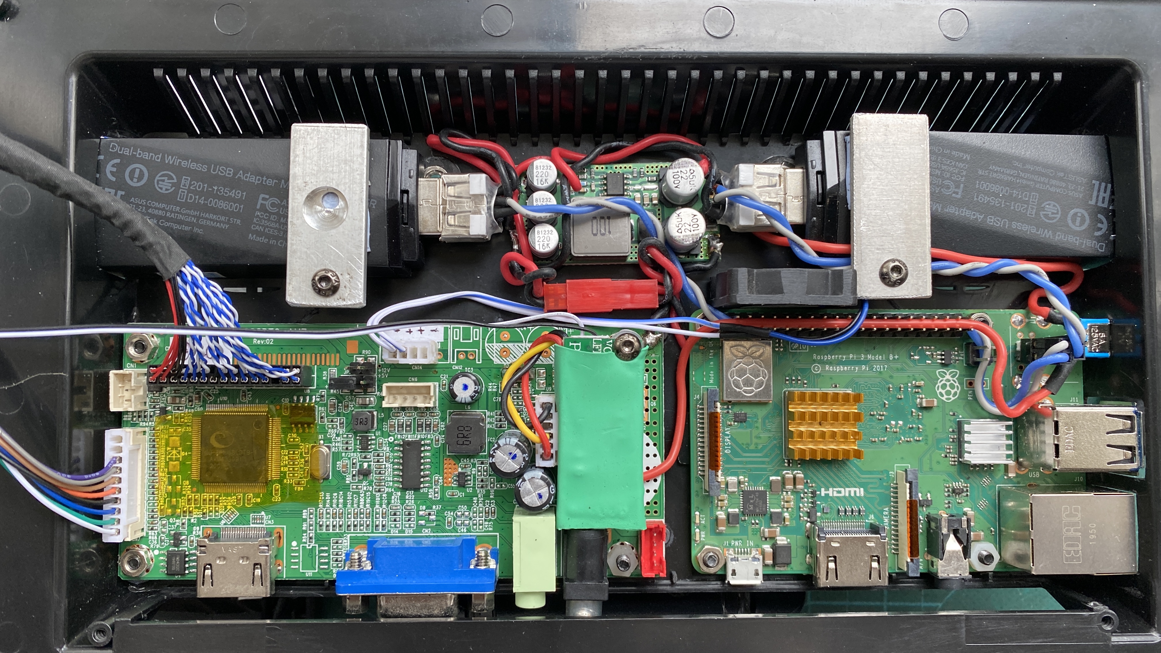

yes ,I put 3s 21700 battery inside, which is 5000 mah , It work almost 2 hours from 4.2 v till 3.0V
