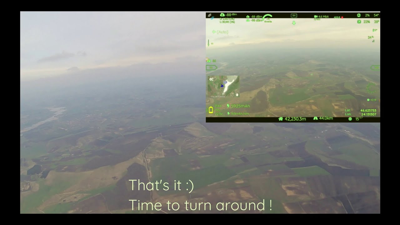

Used bird is mini Crosswind, OHD setup with Asus ac-56, raspberry pi 3b+, Maple leaf air, Maple 17db patch on tracker and Interline 23db on tripod at receiving side.

With this battery and rc (about rc I’m not sure, where is it’s limit) , an 50k max to be on the save side could be possible.
For 60k, I will need one more 6s1p in parallel with existing 6s3p to have a total of 20Ah available. Average consumption is ~ 113mah/km, do the math… ![]()
